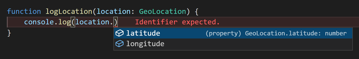

Autocompletion
One of the other features of TypeScript is autocompletion. With TypeScript, you can define the shapes of Objects.
Imagine that you have an object with two properties: longitude and latitude. You can create an interface to define this as shown:
interface GeoLocation {
longitude: number;
latitude: number;
let gpsLocation: GeoLocation = {
longitude: 16.373819,
latitude: 48.208176,
TypeScript gives you auto-completion because it knows the structure:
TypScript autocompletion
