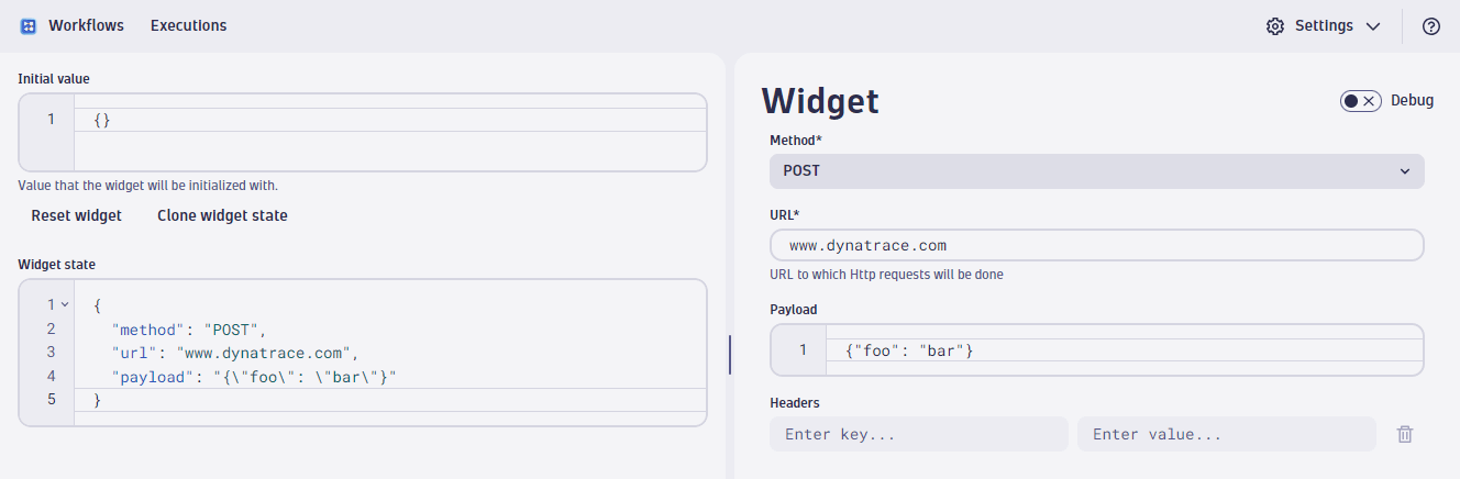

Debug the action
Workflows offer a dev-helper tool that helps you debug action widgets.
Dev Helper
You can access the dev helper via the links displayed by the dt-app on your terminal after executing the npx dt-app dev command. The link points to the Automations dev-helper app and its URL follows this style: https://<your-environment>/ui/apps/dynatrace.automations/dev-helper?src=<widget-url>.
